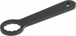

    When you get ready to tighten the axle nut get one of these. https://www.amazon.com/OTC-4882-Rear...5041893&sr=8-2.
    With it you can achieve the specified torque using a 120 lb-ft torque wrench.
