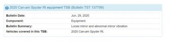

    Sure, BRP has a fix that your dealer will install at no charge, but what the hell good is it if it's not available ?

    Just for information purposes. BRP will install the fix for free as part of a Technical Service Bulletin.
