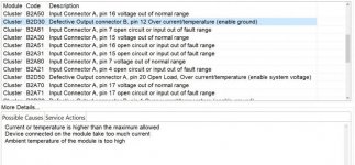

    The closest code I could find is B2D30. May I suggest the next time, if it happens again. Take a picture.

    I received the "!" today on my 2020 RTL when stopping at a light - and it only stayed on for a minute or so and went out.
    When I got home I checked the codes and had the following - B2A30, B2A31, B2A40, B2A41, B2D30. I purchased my Spyder used in January (never checked codes until today) and have ridden 3k miles since purchasing and total miles is 11.5k at this time.
    Do these codes get overwritten if there is another event or do I clear them?
    I can see results for 2 of the 5 codes above ... not sure of the severity. I have shared these with a local Spyder repair guru and was also looking here for any insight on the codes and/or any remedies needed.

    My service manual says, BO to B3 = Body (Including luggage compartments) Thats all that's listed about them.
    I would clear them and see if they come back.
