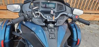

    Do you have a picture of the Attitude bars on your RT? I'd love to to see it.

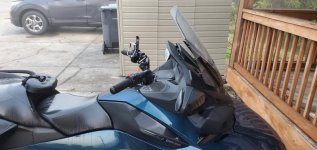

    Here ya go.

    Thanks, they look good. Would you say the the grip height and distance from you is similar to stock, but the wrist angle is significantly changed?

    I'd say that's about right. The inside of the grips (where the grips meet the bars) are probably a little bit higher and the grip ends are probably about the same as stock. The grip angle is great. If I didn't want the grips a little higher, I'd keep these on and be happy. Much better than stock.
