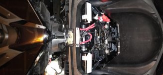

    I have a 2020 F3S Special Series too. The USB cable should be routed into the frunk. You might have to remove the frunk liner and route them in yourself if the dealer didn't do it. The cables will be there in front of the battery.

    I have a special series f3, the usb and 1/8 connectors are routed through the frunk liner into the frunk. There are no speakers on the SS, so connecting to the brp connect is kind of pointless. I deleted my connection to the bike and use sena evo 20s communicators for driver and passenger helmets. I can make/receive phone calls, listen to music from my phone, and talk to passenger. All through Bluetooth. Hope this helps!

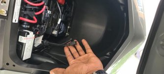

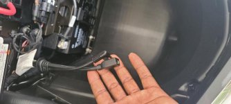

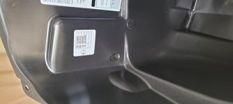

    I have a 2021 F3-S Special series and i had the same problem. There is a usb connecter and a aux cord connecter in the frunk, take out the liner in the frunk as if u were trying to get to the battery and u should see the connecters

    Quote Originally Posted by fullyallamathic View Post
    Thank you. I'll look today. Still questioning the logic behind the non inclusion of usb chargers when the cheaper Ryker has them
