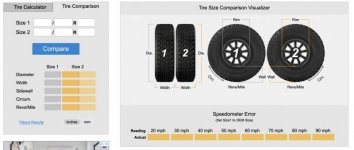

    Tire Comparison Calculator
    There are a number of calculators out there.
    This one allows for comparison say from your OEM size to whatever size you'd consider changing to.
    If you're looking for a "car" tire and the aspect ratios available don't match the OEM you can determine what the new diameter, circumference, speedometer error, etc will be.
    Most importantly, does it fit in the fenders.
    Give it a try

    Just beware, those comparison charts rarely show any SPECIFIC size comparisons between different Brands, types of tires, tread patterns etc - they usually only show a comparison between the NOMINAL sizes that are written on the sidewalls, and the ACTUAL physical size of any tire may be significantly different due to differences in the way each manufacturer or even each different tire type may be measured!! Some use the pre-tread tire carcass to determine the closest nominal size; some include the tread base layers but not the tread depth; others use the size of the final production tire including the full tread depth - but none will tell you that up front!!
    So while these calculators/comparison tools are a good starting guide when choosing tires, you still really need to compare the ACTUAL manufacturers specs of any tires you are considering, usually the Rolling Radius or Diameter, or the Revs per Mile will allow a direct comparison But even then, if you find two different tires that have exactly the same dimensions, chances are that manufacturer took the lazy way out & only provided the Nominal size details instead of their tire's actual physical dimensions - different tires are very rarely exactly the same size as any other/brand of tire/tread pattern.
    And just by the way, the OE Spec Kendas on our Spyders/Rykers have a relatively small diameter tire with that Nominal sidewall size, but they are relatively wide for a tire wearing that Nominal size. Still, for the 2013 & on Spyders, most tires in 50, 55, 60, or 65 profiles between 205/65R15 up to 225/60R15 will fit on our Spyder rear rims & work pretty well; while most similarly profiled tires between 155/65R15 & 175/60R15 will fit up front, altho some Owners have found/managed to squeeze 185/50 or 55R15's under the fenders, some with spacers - but BE WARNED, if you increase/decrease the rolling dia/revs per mile of your tires up front, you should at least aim for a reasonably similar increase/decrease in the rolling dia/revs per mile on the rear. Changing the proportional rolling dia too much between your front and rear tires can make your Spyder feel a little unstable, even if the Nanny does usually intervene before it gets too ugly!!
    But again, please don't solely rely on those tire size comparison apps &/or charts; they usually only compare NOMINAL sidewall sizes & not the ACTUAL physical sizes of specific brands &/or types of tires, and they are really only intended as a GUIDE to allow you to start your tire selection process - you still need to compare the ACTUAL physical dimensions of any replacement tire to a tire that's know to fit, or you risk being embarrassed when it comes to installation time!
    Good Luck!

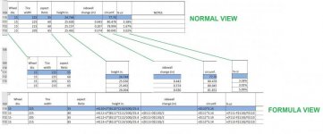

    With all of this considered, I prefer to do my own calculations in an Excel spreadsheet where I can look at multiple sizes all at once instead of just two at a time. This can be as few as two for comparison or as many as you want to copy down with the rows from the first and second ones.
    Here you can see three size choices as it normally appears in Excel. I then broke it into segments in the second grouping with the last grouping showing the formulas used. I did not do a revs/mile formula as I was not concerned about that at the time. All I was really after was getting an approximate size that would deliver a fairly accurate speedometer correction based on the error I was seeing when compared to GPS readings.
    Before anyone points out GPS readings are not accurate, they are dependent on where and how they are taken. Here in the Tx Panhandle, you can find roads that are almost dead flat and straight for miles & miles. That allows for very accurate readings, especially on clear days where your GPS is showing 5 satellites.
    I chose the 205/65 as the change in circumference (%cir) was pretty close to the error recorded from GPS. After mounting and test riding with the same two GPS units as before, my results were astounding. At 75mph indicated both GPS were showing and actual speed of 74.5
    Bear in mind, the manufacturing variances Peter pointed out though. I got lucky with my choice in achieving an almost spot on speedometer.

    Quote Originally Posted by cruisinTX View Post
    The chart Only gives a " MATHMATICAL " size. ..... Actual tire size will different depending on which manufacturer made that tire. ..... Mike
    Hence, the reason I said, "Bear in mind, the manufacturing variances Peter pointed out though."
