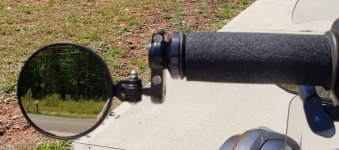

    I agree! OEM mirrors are just not in the normal line of sight. I mounted these KIWAV Lucifer mirrors to my 2019 F3T, and configured them to flash white as a running light, and get a cool sequential amber turn signal. Also like the shape that complements the F3. It is not plug and play, but not difficult to tie into the turn signal cable. https://www.amazon.com/Motorcycle-Tw.../dp/B07JHPC9CN

    Those are really cool! But I am a minimalist and the less hardware I mount beyond OEM is best. I have sequential signals already built into my custom "signature" light. If you are of my philosophy about minimal additions to your Spyder, check my page at the link in my signature. As always, YMMV
