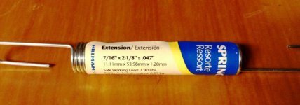

    Like the other Mikey mentioned above, this 'lights staying on' thing could be because the micro-switch on your brake pedal is still open, it's happened to quite a few Spyder Ryders over the years. So the next time this happens to you, try pulling the brake pedal up & see if the lights go off?! Failing that, getting some Contact Cleaner spray into that switch &/or the wiring plug might resolve the problem....
    If pulling the pedal up does work at getting the lights to switch off, then it could just be that the return spring is a little bit light for the pressure you've been putting on it - heavy boots, maybe or is it possible that you've fitted a bigger brake pedal?!
    Fitting a bigger/wider brake pedal might make it easier for your foot to find the pedal, and that's great (necessary even! ) but they are also usually a tad heavier than the OE Pedal, so you might need to help the return spring a little!
    Regardless of the bigger pedal thing, there are threads & pics with details of suitable 'additional' or 'Extra' Return Springs that you can fairly easily fit to work in tandem with the OE Pedal Return Spring - you can search for details thru the Forum's Search Facility, or even thru Google, just add 'site:spyderlovers.com' to your search string if you do (that way, google will search the site, but do it in ways the site search engine can't! )
    Or you can check out the attached pic below - it shows one I prepared earlier.... err, the extra spring some have used!
    Good Luck!
