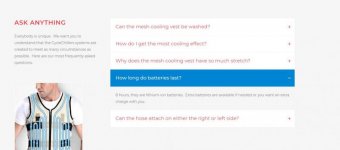

However, I would strongly suggest you contact Cycle Chillers and ask them what batteries you need. The photo seems to have large plugs for the battery. I could not find anything regarding batteries on their site.

I looked at their site a bit more. You can buy the battery needed and a charger for ~$40. They are Lithium Ion batteries. But, I bet today they are Lithium Polymer batteries. They are interchangeable. Extra batteries are available, too.

Did you check out the recommended battery? You can have more than one battery for use if you need more than 8 hours of cooling.
