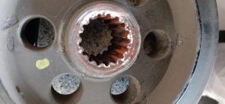

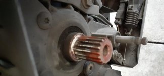

    Today I did an R&R on my front pulley in the name of preventative maintenance. I have on 5K miles on it. It had no play and slid off easily. There was a white grease on the splines, which I suspect was not a moli paste as my paste is grey. Removed the white and applied the grey. All is good.

    Can ya’ll please help me understand all this ‘fuss’ over the “red dust”? I’ve taken photo after photo into my dealer and showed them what folks are talking about and they tell me that rust on that part is “normal”. But that’s not what I read when folks complain about it. Where is the sprocket by the way (sorry female ryder here and I don’t know all the parts).

    The pulley is at the front of the drive belt. If you have red dust (rust) that pulley should be removed and examined STAT. If the splines are in perfect shape, clean both splines thoroughly, apply a thin veneer of moli paste (not moli lube) and install a NEW BOLT and torque it to 92 ft/lbs.
    If the pulley's splines are worn to any degree, replace it.
    We're talking a half hour job here, don't let the shop charge for more. If you can't do it, maybe a friend will lend a hand.

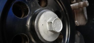

    First, buy a new bolt - do not reuse the old one. Have the parking brake set. With a propane torch, heat the bolt head and remove it. Release the parking brake, lift the rear wheel off the floor and while hand rotating it, walk the belt off the rear pulley. Now you can slide the pulley off. Clean the splines of the shaft and pulley really good and apply a thin veneer of moly lube to both splines. Reverse this process to reassemble.
    What type of cleaner did you use to clean the splines?
    I either used contact or brake cleaner.
