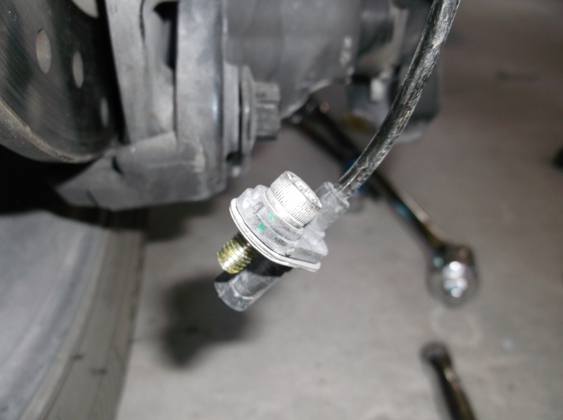

    I have a friend that has a 2014 RT and when changing the tire and replacing the trailer hitch,
    He broke the black cable as shown in the picture below, can anyone tell me what to order and from where ply?4E65D3F0-AC8C-4D0E-AF3E-605BDE60CA32.jpgB35926A3-CC5B-435D-9CFC-B4F2DD1F04AF.jpg

    Looks like wheel speed sensor

    I took a picture of mine to show where it came out of. Here it is32057F51-CA28-4204-8EFA-47AF66FB0BA7.jpg
    From this pic that is a sensor, can tell it is align with the “teeth” of the slotted disk. Found 2 (electrical rear)speed & wheel quite a bit different price

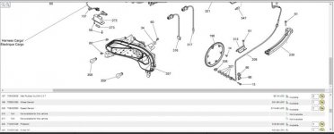

    i went to BRP Parts Catalogue and looked up the #706200560 on the picture and they call it a speed sensor $114.99

    I would agree with that. Item 208.

    Yes, that is the ABS speed sensor. If you remove it be absolutely certain you retain the orientation of any spacer washers (actually shim size washers) when you reinstall it.
