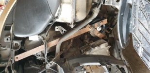

    In a previous post, a photo shows how one person fabricated a long pin spanner to hold the pulley from rotating while loosening or tightening the retaining bolt.
    The required torque is actually not that much, and far less than the drive belt is rated for. Myself, I allow the drive belt to prevent movement of the countershaft while loosening or tightening the pulley retention bolt. Set the parking brake to prevent rolling the machine while accomplishing the task.
