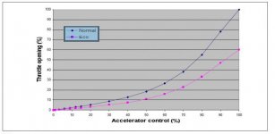

Originally Posted by JayBros
While it's a pretty good graph, that particular graph is actually the throttle response/% opening vs throttle input graph Jay, comparing the Stock/normal throttle opening % response to the downgraded opening response once Eco Mode is selected, & has nothing really to do with either power or torque!
The torque graph for the 1330 starts out climbing pretty well from idle then levels off & plateaus for a bit between 3 & 4,500 ish rpm, before once again climbing fairly quickly up to peak torque at a bit over 5,000 rpm & then showing a fairly slow & gradual decline that's just off level until you get close to the red line, when it drops off rapidly as you reach it! The torque curve for the 1330's is almost a 'one-hump camel back' profile; as opposed to the nothing much at all from idle until about 3200 rpm on the V-twin, then a rapid & steep climb (like you've got on the graph above) pulling hard all the way to peak at about 8,600/the red line & then an almost instant drop off.... or an even better/taller/steeper & higher line with the ECU Upgraded! and yet the ECU Upgraded improved V-twin performance can still be kept within the 'safe & reliable parameters' for the same Rotax V-twins with their stock tunes when used in other applications!
An ECU Upgrade for the 1330's can pretty much completely remove the first flat spot/plateau out of their torque curve, giving you a steadier & more progressive climb with no hesitations, before basically holding it's (higher) own all the way to the red line too!

I looked at the torque graph too and saw how it drops off beginning at about five grand but stuck in the acceleration control graph based on my experience with my Spyder. IMO accelerator control is the thing that gives me the best ability to do what I want quickly, even if I have to kick it down a gear or two to execute the maneuver I want, generally a passing one. Now that the bike is past its B.E.S.T. extended warranty expiration I occasionally kick around in my head popping for the ECU upgrade but I can still get in over my head with it stock if I don't control that hooligan impulse that lives in me.
