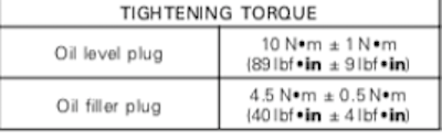

    Default GEARBOX; New Torque Spec. in Purchased Manual.
    GEARBOX: The oil level check screw WAS? 133 lbf/in. (11 lbf/ft) I just check my oil level the other day. I was wondering why the copper washer was flattened down so much. It was not cracked or leaking.
    UP TO DATE TORQUE SPEC. is 89 lbf/in. (7.4 lbf/ft)
    The SMALLER drain plug for draining the ENGINE OIL is still 133 lbf/in. (11 lbf/ft)
    Both larger drain plugs are still 22 lbf/ft

    FWIW, you might consider amending your mentioning of “ft/in.”
    There is no such torque expressed that way.
    If you look again at the manuals spec, the use the term lbf in or lbf ft.
    lbf represents pounds force.
    in represents inch or inches
    ft represents feet
    Converting lbf in = lbin or as commonly stated inch pounds of torque
    Converting lbf ft = lbft or as commonly stated foot pounds of torque.
    I suspect the use lbf since Newtons is a measurement of force, not weight.
    Misunderstanding and thinking lbf as foot pounds will be 12 times more torque when they truly state lbf in.
    All the best with it. I can see more than a few stripped threads on engine cases...
