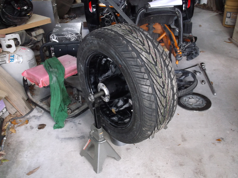

    2019 F3-S I put this on rear of mine. Fits with no problems and rides good. Kendas on the front still plenty of tread at 11,000 miles.
    https://www.amazon.com/Kumho-Ecsta-K...s%2C172&sr=8-1
