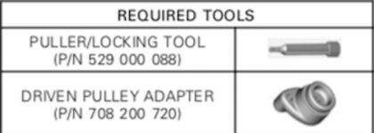

    Default Cvt Belt Replacement
    Special tool required

    Thanks for sharing! That looks very simple and straight forward!

    It is rather basic.
    Opening up one sheave, for the belt to go closer to center, allows the belt to slide over the edge of the other.
    Sheaves are supposed to be cleaned and checked for smoothness, versus ridges.

    I wonder how much those special tools cost....most likely cheaper than the labor costs. Luckily I'm not close to needing them yet.

    Both together about $40
    I prefer to do things myself...not just for cost consideration but tinkering is part of the ownership enjoyment...as well as getting better acquainted...and staying busy in retirement.
    My dad retired early at age 58 (his dad only lived to 66) and often commented that he did not know how he found time to do everything he wanted before retirement. He lived to 91.
    For a simple engine oil change, would a Can Am mechanic take the time to clean the magnetic drain plugs as thoroughly?
    Very nice! That is less than I would have guessed

    Example
    https://parts.adrenalinecycles.com/P...aspx?WID=10928
    This is on a Can AM Meverick, but same tool
    https://www.youtube.com/watch?v=M3slSbzq4nQ
    This video is what lead me to think that only the 8 mm bolt (8mm x 1.25 pitch x 50 mm + length) would be needed...but appears that hub is different.
    https://www.youtube.com/watch?v=xR838ZLGCuU
    See 3:10
    Still looking for video for Ryker

    And thanks for posting info....specially on price on where to buy the tools...I might do that soon.

    Yes, prep is a large percentage of a project.
    From the video clip, I cannot figure out why the 8 mm, 1.25 pitch bolt has the special tip.
    It appears to go against the aluminum hub, with something to protect the hub, such as a coin.
    I may buy that at a hardware store and then buy BRP for the other part.

    It appears that the 708 200 720 "driven pully adapter" should be the same price at a Can Am dealer as on-line sources: $26.99.
    My closest dealer (Rancho Powersports) stocks it for $30.33.
    The dealer where I purchased the Ryker stocks it for $30.71 including taxes (~$28.37 without)
    Lookiing at this PDF of a Can Am CVT manual, which is NOT our transmission, but nonetheless quite informative, I see no reason to not use a standard 8 mm, 1.25 pitch bolt, at least 50 mm long. Somewhere I read 80 mm, so I will go for longer.
    https://static1.squarespace.com/stat...tch+manual.pdf

    Hi!i would like to know where did you take that picture from? Is it from a BRP manual?
