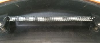

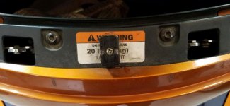

    Here are a couple of pics of what I did so the lid would pop open some when the latch is pulled. When I close and latch the lid the spring between the catches is pushed upward by the block on the trunk ledge. There's enough force in the spring as it wants to straighten out to lift the lid enough to get my fingers under the edge and lift it when I pull the latch. Until I did this I seriously considered putting a handle on the lid to lift it open. Later, when I added the rack on on top I started using it to lift the lid.
