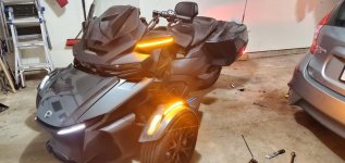

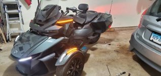

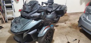

    I chose to install the mirror LEDs in a way to mimic the design from previous model year RTs. Here are some photos with the lights off, then on on and another with the blinkers running.

    Here is a photo of the final installation during the day. I'll post a night time shot when I get one.
    OK, Here's the photo at night, with apologies to JJ Abrams.
