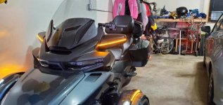

    Since this thread started, I've made two improvements.
    First, I used Lamont's technique to minimize the mirror shake. This will hopefully eliminate the source of the covers coming off.
    Second, I installed Spyder Pops Vision Kit. This includes two run/turn signal lights at the mirrors.
    I chose to install the LED light strip on the front of the mirror to mimic the old turn signals.
    The wiring to the LED light will act as a lanyard if anything should happen.
    IBA #47122
    2020 RT Limited Asphalt Grey
