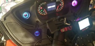

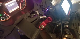

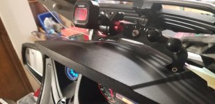

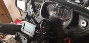

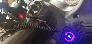

    I ran auxiliary wiring from the fuse block I set up for power - as the link above: https://www.spyderlovers.com/forums/...ribution-block - Here is a link to a video of "Coach Bob" running a single wire to the USB rocker switch outlet: https://www.youtube.com/watch?v=8I7q00fnVA8 Instead of using the auxiliary power point to energize the solenoid on the power block as I did, he ran wiring right to the USB rocker switch. For more than just power, you could plug an extension into the information port and run a line to the same area. If you are wanting to mount something near the hand grips, while I ran the wire to the rocker switch USB I also ran power up through the handlebars to a cigarette lighter style power outlet. I routed the wires as Coach Bob explains, but one went up between the handlebars, leaving slack so it wire won't get pulled when the bars are turned. I unscrewed the plastic back of the bars ran the wire in the cavity and the wire comes out a small hole I drilled to the outlet mounted on a Spyder Cuff. Run the wires through the hole in the plastic on the back of the bars before you attach the woring connectors. (Don't ask me how I know this) Photos are the USB rocker switch and the wire out of the back of the bars to the cig lighter outlet (round part behind Spyder Cuff)
