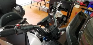

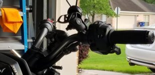

    We have a 2020 RT. Stock bars are perfect for me; I have long arms. SpyderAnn, not so much. So, took a measurement of reduced reach bars. Not optimal. Then friends who got reduced reach bars confirmed what we thought: too close for comfort. So, the next idea was stock bars, add ROX risers. The handlebar top clamp fouls the riser. My friend Chris confirmed that F3 handlebar top clamp is the same bolt pattern. He bought one, put ROX risers on, boom! Fixed! $16 bucks! ROX risers are 125-175 a set. Had a set of F3T stock bars. Had a friend who had a similar issue. Fitted our bars to her bike. Gave them away in the spirit of testing. Fit perfectly. Then took delivery of our RT. Now I need bars. Posted up, and some nice folks sent me some to test. Today, I bolted up a set of F3T bars, and SpyderAnn is happy!
    We saw that they don’t fit on the internet. Well, they do in my garage! If you need new, less than risers. Plenty of used ones out there; lots of people swapped out the stock bars for one of the 5 U-Fit options. Until a couple of weeks ago, I had a set gathering dust. Check it out:
    Stock 2020 bars
    Compare
    Done!!
    Use a Allen socket, seat it properly. After 3 sets, no issues, just take your time. Enjoy!!
    Special thanks to CruzrJoe, Cowgirl Ann, and A0Lovey. All in, takes less than an hour to do.

    Jerry, Bill: thanks for posting. Quite the difference, right! We wanted to make sure nothing hit, no surprises. Our Beta testers report no problems, and so much cheaper than reduced reach bars, or the ROX risers. Really simple to do, just 8 bolts and a blanket. Take the grip assembly off first, then the bars. Swap the cable guides over, install bars, install grip assembly. Adjust to fit. Done!

    I have a similar issue with the reach on my 2020 RT. I bought the short reach bars, way too close. I bought the ROX risers and F3 faceplate. That fix does not allow for much weight to be applied when mounting or dismounting. I was this ( ) close to ordering the $600 Helibars. I'm going to try your solution Joe. I will do a WTB post here on Spyderlovers and hope someone has a set of F3T bars to sell. Thank you Joe!

    Ok, there are 5 available for the F3:
    Position 3, stock
    Short reach
    Long reach,
    Attitude
    Drag
    The drag and attitude (buckhorn) won’t fit the RT without risers. They hit the dash. I haven’t tried them yet. As I learn stuff, I’ll post stuff. Joe

    What model ROX Risers are you using? The the ROX website they all appear to be of a different design that what your pictures indicate.

    Send a PM to KX5062, they installed Rox on Barbra’s 20 RT. The pictures in this thread are of F3 bars on the RT.
