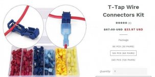

    don't have to cut...……… I found "T-taps" really good for tapping onto wiresCapture.jpg

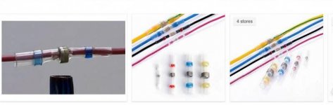

    here is example of connector that has solder right in itself. different sizes, push wires in each side, heat with torch or heat gun, melts solder, and seals up to with special sealant

    used before on different bike , np connected well & couple years or so later was changing to something else. Removal was fairly easy too, simply use a straight edge razor remove insulation at joint & heat the solder while pulling wires apart. Wire comes out tinned at exposed end. Handy when making second connection. Have also tried the T taps mentioned earlier & quite useful when not splicing but adding. Advise finding some that have double “teeth” for better connections without making wire too weak. The spade end helps greatly if you accidentally ran tap wire through non optimal route. *note* the limited space to work with in the mirror housing did bind & break wire on one mirror from my gen 1 lights installed by Tricled (broke where the mirror meets the body)
