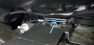

    Ok does the backrest need to come off first I am release the two tabs but it won’t come out
    Mar 2013
    Maumelle, AR
    2,155
    Quote Originally Posted by Benmannino View Post
    On the 2020 RT, yes, the backrest has to be removed first before you remove the seat. Raise you drivers seat. With a flashlight, look under and see the locking pin for your backrest. See the two tabs (blue dots)? That's what releases the locking mechanism. Pull it out about an inch to release the backrest. There are also tabs to release the seat. Look to the right of the blue line. See the tab? There's one to the left also. Those are the tabs that hold the seat in place. Just lightly press in and lift the front corner of the passenger seat. It'll come right off. When replacing it, make sure the tabs are in place before pressing down or you might break the tabs.
