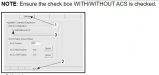

    in rt 2011 Ltd. there was a software option and there are instructions too on BRP web page to mount the self-adjusting suspension in "no ltd" Spyders. Same option with opposite option.
    the dealer did it for me.
    But if the problem is an air leak you will not be able to maintain the pressure manually. To avoid engine, leaks and air tank problems I deactivated the software option and installed a gas damper with double adjustment. Although the conditions are not "optimal" at any time you can achieve a very good compromise adjustement and you'll know that these parts will not be the problem never again.

    We have disabled the compressor and then we used BUDS to change the programming so that it now thinks the Spyder is not equipped with the compressor.
