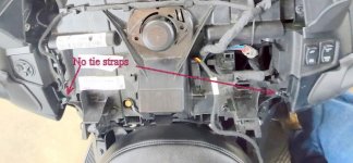

    Sunday 4/12 was the first time my wife rode on the Spyder we drove to the Blue Ridge Pkwy.
    in Virginia only to find it closed also the Shenandoah Parkway. We stopped and I was trying to
    open the right hand rear side cargo door. It would not open. I checked to make sure it was not
    locked I went to the left side it would not open. Went back to the right side pulled a little harder
    and broke the handle off in my hand.
    After I came home I took it in the shop took the rear cargo module off and put it on the lift.
    I could see the rear gap in the back on both sides. But I could see nothing wrong or anything
    that might cause this from underneath or on top. So I decided not to pull it apart to investigate
    because from what I see it's either defective part or a design issue. The rear of these RT's come
    completely assembled from the factory. All they have to do a bolt them on at the dealership.
    This is what worries me. Our ride was on a smooth paved road. It's almost as if both sides
    sank down a little.
    For whatever reason when my wife sat on it that weight push down and causes this problem for
    I had not had any problems opening up either rear side cargoes doors before this. And my wife
    only weighs a 120 something (only she knows)
    There's no fault here to blame other than a part failure or design issue. I have not taken any
    parts off the rear of this Spyder for anything since I've owned it. Again this all came about
    when my wife for the first time road with me Sunday for about hundred miles and the only
    thing was the weight that this now had to hold which for whatever reason caused the issue.
    I look at other pictures of the rears of the 2020 RT's and there is no gap like this.
    I have contacted my dealer who sold this to me and sent them some pictures. I'm just wondering
    if anybody else has come across this yet besides me. Other than this I have been completely satisfied
    with this new RTL Spyder and I still think this is the best one yet.
    Because of the coronavirus as is everywhere else my dealership has limited capabilities now and
    may not be able to get to it for a while. I'm wondering if BRP should look into this before they
    disassemble it.

    Active Member NEXUS's Avatar
    Feb 2008
    Buckingham VA
    194
    Quote Originally Posted by ThreeWheels View Post
    Yes, the photo indicates a locked compartment.
    Yes I know what locked and unlocked is.
    I had it on my overhead lift looking from underneath and I was turning the key
    to see how it locked and unlocked and left it in locked.
    The other side still won't open unlock no matter how hard I pull to the point of breaking.
    If you look at the picture the whole latch mechanism where the handles broke looks like it has
    slipped down.

    Quote Originally Posted by widowmaker2011 View Post
    Mine is the same way , the handles do not fit correct.... based on the technical service bulletin I was thinking this will be corrected when the updated rear plastics get put on. The gap appears to be equal from the front of the rear section to the rear as in your pictures. Can you pop the rear seat and show the rear plastic side attachment points? If yours are corrected (some late production units were corrected at the factory with the updated parts) then we definitely have an issue....If you still have the old style pieces (held by zipties or forced together incorrectly) then this "may" be remedied when that bulletin is completed. My dealer says May 1st is the current day showing for the parts to arrive. However BRP is doing rolling shutdowns worldwide so that is not a date I would put in cement. Interesting either way...... Hope all is well my freind.
    You may be right on that piece of plastic that the tie strips were tied too.
    I must have the new improved version on this model it's the same piece.
    After looking in the service manual and going back after looking at it again
    I am missing on both sides the plastic clips that holds the pieces from the
    sides to this piece.
    Which would make sense because if they were not there or broken the side pieces
    then would fall down and jam the side compartment doors from opening up.
    Either they were not strong enough built or they were never there. And when
    that extra weight was put on it for the first time it pushed it out since nobody
    had sat on it before.

    RT-S PE#0027 widowmaker2011's Avatar
    Jan 2010
    Orchard Park NY
    335
    Quote Originally Posted by NEXUS View Post
    You may be right on that piece of plastic that the tie strips were tied too......
    Are these attachment points (circled) connected with zip ties (mine are) ...... The picture is blurry in that area so I cannot tell. If they are, or they are forced into position , this could be the domino effect that throws the alignment off for everything in the rear, thus the complete redesign of the side support panels that is coming with the bulletin. At least that's how mine appears to be.
    Feb 2008
    Buckingham VA
    194
    Default No Plastic Tie Strips on Mine
    There is no tie strips on this piece of plastic like yours. This must be the new improved
    that they're going to replace yours with. I'm absolutely positive the clips on the back that
    are missing this is what caused this issue that I have now. Whether this happened on the
    assembly line or design I don't know.All I know is they're not there.
