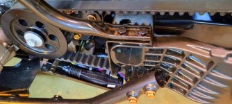

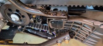

    Default Installed Belt Tensioner on 2020 RTL
    Quote Originally Posted by upsdoctor View Post
    Nexus, thanks for the info. Please let me know how you make out. I will order the same parts if you are successful.
    I did about 100 miles Sunday 4/12 with this belt dampener no vibration at all.
    Traveled interstate for 30 miles testing different rate of speed from 70 to
    90 with no vibration luckily I didn't bump into any state troopers.
    As far as installation it took about 10 minutes to put the belt dampener on
    once you get the Tupperware off. I give this level about a 2 from 1 to 10.
    Purchase it through will Slingmods ( SpyderExtras Billet Aluminum Belt
    Tensioner / Idler for the Can-Am Spyder RT)-$179.00 no tax or shipping.
    There may be cheaper ones out there but this is well-designed and roller
    bearing assembly is replaceable.
    You could easily do this in two hours if not less once you get the Tupperware off.
    I can post a more detailed step-by-step instruction on how to get the Tupperware
    off if needed.

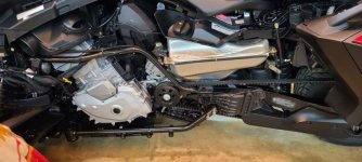

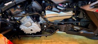

    Default Tupperware Removal for Installing Belt Dampener
    Quote Originally Posted by Guzzi View Post
    Nexus! Send instructions on how to remove Tupperware, please.
    There are many ways to take things apart this is my mine.
    Many of you will have another way.
    1 – raise seat and front hatch.
    2- pull number 1 first that just snaps in
    3- pull number 2 off it also just snaps in
    4- remove screws and pushing rivets on number 3 very easy to see. One thing on this
    careful on removal of the sharks tooth that hangs out in front it rubs on that large
    plastic piece.
    5 - remove both number 4’s the floorboard is just three Allen screws and
    one bolt holding on the passenger step. You may not need to really remove
    the floorboard but it's so easy to do to get it out of the way.
    6- this one large piece number 5 only has one screw it it the rest are plastic pushing rivets
    the one underneath the front nose is a Phillips plastic screw unscrew this it popped
    right out. There is one push in rivet that's hard to see and get to. I point this out because
    it is a little difficult to get to pop out without lifting it up a little or using a mirror.
    On this large piece pull the front out from underneath rotated up to get it out from underneath
    the back.
    Putting on the belt dampener from here is really simple follow their instructions or video.
    Also have a place or blanket to put your plastic parts on its easy to scratch these things.
