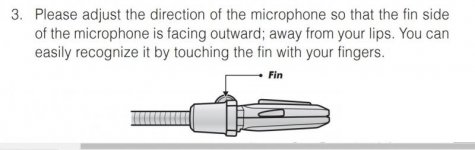

    The microphones on the Sena units are noise cancelling. That means that there is a pickup that faces into the wind and a second pickup on the opposite side that picks up your voice.
    There is a marker on the microphone that should be pointed "out" away from your mouth and into the wind for the noise cancelling function.
    Is it possible you have the microphone rotated backwards ? That would pick up the wind and cancel the voice instead of vice versa.
    It's REALLY easy to make this mistake.
    Don't ask me why I know HOW easy it is....................................

    Quote Originally Posted by ThreeWheels View Post
    Ya there's a little tab that's suppose to be pointing toward you, take your finger, you'll feel it at the base of the mic. The mic on my wife's helmet wants to turn by it's self, drives me crazy, it's like it got assembled 180 out!

    Mine were the SMH 10’s. Had noise canceling feature enabled and the mics the right way, even tried covering the the outside facing port with duct tape.
