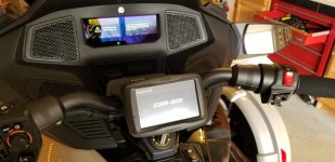

    There is one on the right side. I have my Garmin 590LM GPS hooked up to it. It's only powered when the key is on.

    His Facebook post is spot-on. Just did mine and used bullet/barrel connectors that you can get anywhere. Shrinkwrapped the connectors and then wrapped it up in some plastic for extra protection from water splashes. Used plenty of zip ties.
    It is easier to fish the wire from the GPS from the handlebar area if you remove the speaker grille - it just pops out. If your hands are huge, you can even remove the speaker itself for more room.
    Removing the 3 tupperware body panels is not a big deal - just don't force anything.
