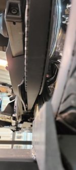

    Retail, check out this Vlog by Smoaks about 6 mins into the video. If you're not aware, this guy is a RTL tech guru. So is that a newer class DD? I sailed on one for 4 years, Korean War vintage. https://www.youtube.com/watch?v=tdAnV1qrPso&t=1371s
  18. #43
    Member Redtail's Avatar
    Jul 2020
    Durham, NC
    21
    Thanks for the link to the Smoaks Vblog. Good stuff. I'm not sure he's talking about the same sound though. This is a high pitched whine that occurs only at 48-51 mph. Below and above that range, she purrs. Then again, it's my 1st Can Am and I've only had it for a month, so I could be wrong. I did call Can Am North America today to see if they knew anything about it. Of course, they did not. After I told the nice young lady that several other people on SL.com had cited the same issue, she said she would let the social media team know about it. Ok. Am I turning blue yet from holding my breath?

    I was back at the dealer today to do some accessorizing and had a talk with the service manager about the persistent whine at 50 mph. He said that he wasn't aware of anything having been reported to BRP or the 2020 RTs, but would double check. He caught up with me a little while later with interesting news. BRP is, in fact, aware of the issue. Apparently they got the ticket on yours, Sharp. BRP attributes it to exactly what Smoaks said in his vblog -- air trapped between the belt and the pulley being expelled under pressure. You were right Bikerbillone! BRP claims that the whine has always been there but because of the way the pulley was shrouded on pre-2020 models, it was much less noticeable. The shrouding changed with the 2020 redesign, so now it is more pronounced. According to the service manager, BRP is in the process of redesigning the pulley to mitigate the problem, but when a fix might be available is anyone's guess. So for now, please join me in becoming a "whine aficionado." Crank up the stereo and ride on!
    And because of the way velocity interacts with air flow the fact you hear it a specific speed range makes perfectly good sense. An example, although not directly attributable to this case, was one day I was carrying my aluminum extension ladder on my pickup, propped up between the tailgate and top of the cab. In a certain range of speeds I heard a howl as the air passed by the ends of the open tube ladder rungs. The howl was only in a particular speed range.
