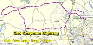

Looks like a nice unit! Please let me know if the "curves ahead" and other warnings works well and if you can turn it off. I had a Garmin 56 that included those warnings and the first time I took it out in the mountains on my Cleo Chapman Highway route (made it in Base Camp) it would sound all the time to the point it locked up the upper bar where it once had told me what turn was coming up! Really bad. My 57 doesn't but still bugs me with school zones whether or not they even exist or not. Injoy!
You can see my Ohio and some South Carolina routes with downloadable gpx and kml files for garmins and map illustrations like shown.
to see MY maps PAGE
