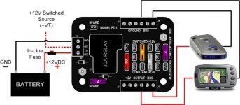

    I'm about to add a fuse block. I have used the FZ1 switched fuse block on 4x4 vehicles and had great success so I'll probably use it here as well.
    https://www.fuzeblocks.com
