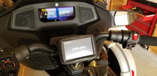

    There is one on the right side. I have my Garmin 590LM GPS hooked up to it. It's only powered when the key is on.

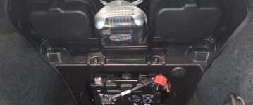

    I ended up putting my accessory panel between the two in the front trunk.
    Easy to get to, battery connection right there, and you can zip it back up
    and will be out of sight.
    The accessory panel is a Tsunami TSFDB 14ATM this I'm afraid is no longer available
    or I can't find it on the Internet. I had bought an extra one when I put this on my 14.
