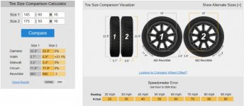

    I don’t need to change any yet but the closest I could find for the front was a 175/50/16. Looks like the fenders could be shimed.

    Going from the 145/60/16 to a 175/50/16 is a big jump in tread on the ground. Diameter is identical. But a 21% wider tire is going to add some unnecessary drag as the current 145/60 has no traction issues. You're going to have to find room for over 1" more tire under the fender too. That will require at least 1/2" more clearance on each side. Haven't looked at it. But that is quite a bit.

    I have had an RS, a ST Ltd and a F3T. I am about to pick up an Ryker Ace 900 and know I will likely want to change the front Kendas before they wear out if they are anything like the Kendas on my other Spyders. I have been playing around with online tire size comparison calculators and wonder if the following might work - 165/50R16. the differences are as below - similar in size except about .8 "" wider. Any thoughts if those would fit under the front fenders? If you search you will find the FEDERAL FORMOZA AZ01 in this size. Thoughts?
    145/60-16 165/50-16 Difference
    Diameter inches (mm) 22.85 22.5 -0.35 -1.6%
    Width inches (mm) 5.71 6.5 0.79 13.8%
    Circum. inches (mm) 71.79 70.67 -1.11 -1.6%
    Sidewall Height inches (mm) 3.43 3.25 -0.18 -5.2%
