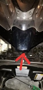

    I am a new 2019 F3 (base model)spyder owner, this is my first Spyder(bought couple months ago). I am loving the new ride. I installed some aftermarket fog lights today and I was going to switch out the headlights to led. I am having an issue removing the nose piece above the frunk. Per Slingmods video, I just need to remove the bolt and lift up on it and it should come off. I tried to pull the nose piece off but it would not come off. I did not force it as I do not want to break it. Should it just come off or should I remove more panels before removing the nose?20200112_195330.jpg

    There is a Torx bolt/nut holding the front nose peice on. I ran into the same thing. You have to gain access to the following screw in the picture. I do not think the 2018 had this and so the Slingmods video just showed it popping off.

    Thank you, that explains it! Now i know how to attack it.
