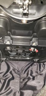

    Active Member MeudtPG's Avatar
    Aug 2018
    Monroe, WI
    160

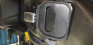

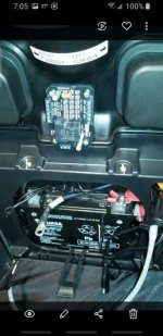

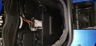

    Here is my install of Fuze Block FZ-1 mounted in Frunk on battery cover secured with aluminum bracket and rivets.

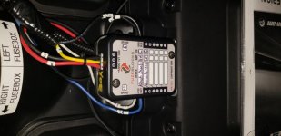

    Active Member INfox's Avatar
    Jun 2017
    TX
    102

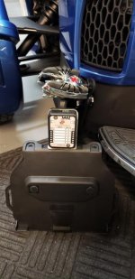

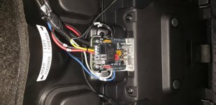

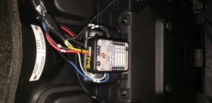

    I used MeudtPG idea to install mine - with a help.
    I didn't want it to be mounted on the battery cover, although that is a very good spot too.
    FZ-1 final.jpg FZ-1 velcroed.jpg FZ-1 velco.jpg FZ-1 w_velcro.jpg FZ-1 glued.jpg Velcro.jpg FZ-1 ElecPlate.jpg
    Mine is glued with and original JB Weld (was tested the best glue to resist vibration by ProjectFarm) to sanded trunk's wall with 100% silicone filled void behind the curved wall for additional support. I can attach the FZ-1 in two different rotations this way. No messing with the wires if I will need to access the battery and the fusebox is more inwards between the Left and Right Spyder’s fuseboxes.
    Right now I have only one wire connected to it, so I chose to have it upside down, but the wires are long enough for the FZ-1 to be flipped. I might possibly screw the mount plate to the cut gray electrical plate for better security if needed, therefore the gap in the center (which is too big on the bike’s wall, oh well).
    My Switched source (inside of gray split loom) comes from a hidden zipped optional plug. I fed this plug through the grommet hole together with new wires inside of an orange split loom. I have a male quick connect on the end of the switched wire from the fusebox to the optional plug. We took off the frunk to pull the hidden optional plug out though as we couldn’t find the wires, which are zip-tied.
