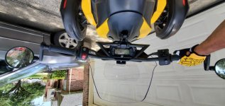

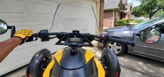

    I bought a windshield for my 2021 Ryker Rally Edition today now I have to put it on or pay someone to to do it for me. This is the bike and the windsheild that's oing on it.
    240675911_4282086788536697_1128264614659035690_n.jpg...241113298_4282132585198784_7071036998401706473_n.jpg

    Quote Originally Posted by Beanz1 View Post
    We have the same one on my wife's bike. Very easy to install, should take you all of 20 minutes with hand tools.
