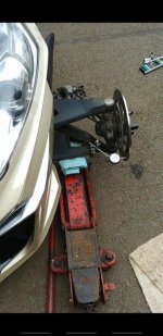

    ….The frame is always the best point from a strength standpoint ….. However I have an Auto scissor style jack that I re-moved the ring and welded a 5/8 nut to ….. to change a wheel put a small sturdy piece of wood on top of the jack so it spans both arms of the suspension close to the wheel and just lift it enough to re-move that wheel..... good luck …. Mike

    Here's a picture....

    thanks, strange there isnt a easy sturdy place to jack the bike up along the road and go het your tire repaired.... so is the a arm stinger closer to the wheel?

    " stinger " ????? did you mean " stronger " …. if so Yes, try this for proof … place the ends of an 8 ft., 2 x 4 on small blocks or bricks etc. …. step on the 2x4 near the block , it doesn't move …. now step in the middle, it moves a lot ….WHY ? , because that's where it's weakest..... hope this helps ….. Mike
