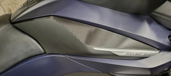

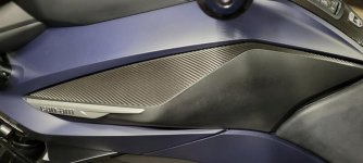

Instead of posting a bunch of messages over many weeks, I decided to just complete as many of my changes and post them together.
From first to latest:
- Revivify Self Healing Nano Coating applied immediately upon delivery. https://revivifycoatings.com/
- Carbon fiber applique from Wrap My Spyder to hide the piano black
- BRP Driver floorboard lights.
- Awesome Flasher and shifter buttons mod from our friends FrogmanDave and TCBoone.
- Show Chrome Fender and mirror flasher mods with custom made plug & play harness.
- Zumo XT with BRP mount on centre of handlebar. Didn’t’ like having to look down at GPS, relocated GPS on upper dash. Much better position and no sky reflection on the display.
- BayaRon Ultra bar and Spring adjusters. Best Mod so far! Excellent handling improvement.
- BRP Passenger armrests. Happy wife, happy life.
Purchased but need to install:
- Show Chrome Saddle Bag Red LED Lights
- B1M Motorcycle Dashcam with dual cameras and GPS
Removed the windshield and thoroughly cleaned the areas that can't be reached otherwise. Looks SOOOO much better.

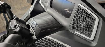

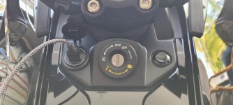

I used almost everything in the Zumo XT box except for a 1 inch Ram ball with a circular base that was purchased from Amazon for $10. Ram Mount.jpg
The Ram base is held in place by 2 small strips of 3M double sided moulding tape. 3M double sided Tape.jpg
Running the Garmin power cable to the small slit on the dash is a bit of a PITA. Because of the obstructions under the dash, routing the Power Adapter cable needs to be done in two steps.
Step 1 - Remove the right side Tupperware
Remove the right side Tupperware, remove the upper and lower right speaker covers; and remove the upper right speaker.
Step 2 - Drop fishing line/cable
To fish the Garmin Power adapter I used a 2 foot length piece of scrap 3 wire electrical cable. I inserted the fishing cable into the right dash slit towards the upper right speaker. With the upper right speaker removed, I was able to grab the fishing cable and pull out a 6 – 8 inch length.
Then route the 6-8 inch length from the upper speaker, down to the left side of the lower right speaker. Right Side Speakers.jpg
Step 3 - Secure and Retrieve Power Adapter
At the lower speaker, using electrical tape, secure the fish cable to the Power adapter cable. Carefully pull the fishing cable back up to the top right speaker first.
Then carefully pull the fishing cable from the dash slit until the Power Adapter is at the slit. Power Cable.png
Step 4 - Expand the slit and pull Power Adapter out
The Garmin Power Adapter is a bit bigger than the slit opening. I used a small round piece of wood that I inserted in the slit to expand the slit enough to pull the power adapter through the slit.
Step 5+ Wrap-up
The worst part is over. Now just attach the power adapter to the motorcycle mount as per the Zumo XT user manual page 6.

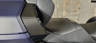

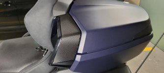

I added an other farkle to my 2023 F3 LTD Special Series.
I added the Front Fairing Access Door Covers Accent Trim Black Carbon Fiber (Domed).
I'll post a picture in MY Album, and on the Spyder Garage.

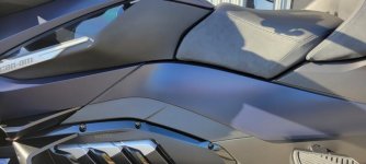

There were some large cracks forming around the mount points on my blue ridge windshield from the deer strike I had a couple of months ago.
Since I was not using my cowl I traded it for a gauge spoiler and continued on with my "color scheme" of metallic blue highlights on certain parts of the F3.
I rattle canned my lug nuts,axle nut covers, the coolant reservoir cover since one of the posts were broken so it's a test subject with the black plastic before I do some other black plastic pieces.
And since my access covers were all scratched up and I didn't want to spend $50 for two pieces of plastic to stick over them (wraps). I did it all in metallic blue. If it takes ok on the broken reservoir cover I'm going to do the belt guard and the other plastic piece on the drivers side.
I'm enjoying the spoiler now with the heat as it allows more air over my mesh armour but I think I will be putting the windshield back on for winter.
The CloverCrawler is sporting a whole new look now.
Update 7/28 : after taking it out in the heat and letting the engine heat bake in the paint and after gently cleaning the spoiler and panels I removed them and sprayed it down real heavy with the Rain-X graphene wax and buffed it out and man it really looks nice and no more fingerprints when I take off the panel and put it back.
This rattle can really surprised me and it's just a can of behr interior/exterior metallic blue glossy from home depot. I just made sure they were clean and wiped them down with 99% iso alcohol before painting them to make sure there were no oils on them.
