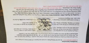

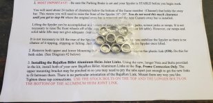

    Hey all,
    Sorry if this ain't the right place.
    Curious if anyone has experience installing the Baja Ron wway bar on a 2019 F3S. Instructions contradict themselves regarding long bolt location, and don't even mention spacers included in the box..
    Much appreciated.

    I actually got it from Spyderpops, with a v2.3 instruction packet. Step 3 seems to contradict itself, and nothing mentions these bushings.

    Quote Originally Posted by mcap View Post
    Anytime you have an issue with any BajaRon product, question, whatever. You can always call or email me (info listed with all instructions).
    The current version for the F3 is v3.0. If you don't have that version then you do not have the current set.
    I have updated all of my vendors with current instructions. But that doesn't mean they are necessarily sending them out. Sometimes they build kits and put them on the shelf and they may sit there for awhile. Especially if they put new builds on top of the older builds. You're still getting the same product, just not necessarily the updated instructions.
    If you send me your email address. I will send you a PDF copy of the latest version for your Spyder.
