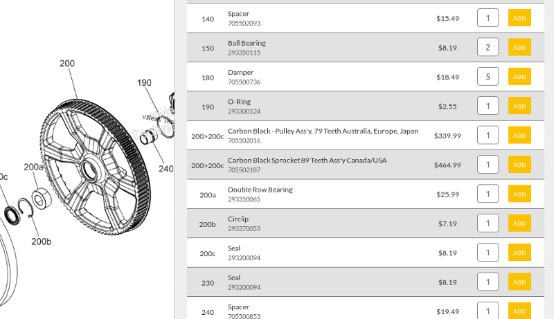

    2019 F3 all models come with a 79 (small) toothed rear sprocket. 28 up front like all the others. Earlier US models had an 89 tooth rear.
    This has been corrected. S has 89 teeth.

    I thought the 2019 F3s still had the 89 tooth

    Quote Originally Posted by Jengland View Post
    Parts list items.....
    Carbon Black - Pulley Ass'y, 79 Teeth Australia, Europe, Japan
    705502016
    Carbon Black Sprocket 89 Teeth Ass'y Canada/USA
    705502187
    2019 F3-S , Black & Silver
    Mar 2017
    877
    Quote Originally Posted by Gwolf View Post
    705502016
    705502187
    xxx xxx xxx

    Quote Originally Posted by Rattlebars View Post
    Parts list does not show the "S" having 89 tooth. Only 79 is listed ->https://www.partshark.com/oemparts/a...ve-system-rearisted.
    The parts list you linked looks exactly like the one I use. I see both pulleys listed on it. They can call it a pulley or they can call it a sprocket, it is the same part. The part number is the same. Only the region and what they are calling it is different, with different number of teeth.
    Mar 2017
    877
    xxx xxx xxx
    Apr 2019
    Florida Swamp
    1,961
    All the other years and other 2019 models have two pulleys in the fiche picture. I defer to your expertise. Have you tried to buy one?
    No, I have a 2019 F3-S that came with the big pulley.
