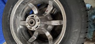

UPDATE:
I did the wheel removal and tire install today. Following every ones advice, the job it's self was pretty straight forward. Took longer to get the tire mounted on the rim than doing the work.
What did I learn:
Removing the sensor in the swing arm was the worst part.
I tried to remove the belt with out taking the shock bolt out. I was not able to do it that way, once I removed the bolt from the shock there was no problem.
Bearings and seals looked good.
The manual shows removing the hub, my wheel has a solid hub nothing to remove ( I guess that is what you call it) the brake disc mounts right to it I removed the brake disc on one side and the drive pulley on the other.
Mr. Tire had no problem mounting but said he never seen a rim like that and could not balance it, did not charge for the mounting.
I reinstalled wheel and torqued to specs too it for an extended test ride, would never no it was not balance super smooth.
Tire is a 205 60 15 Quad Trac 5

Just FYI, there is no need to remove the brake rotor (or the hub on the older wheels) to mount a new tire. Most tire shops do not have equipment to balances these, they require a motorcycle tire balance machine because of the small bore.
Even though I did not get it balanced, you would never know it is actually better than some balanced tires on my Audi Q7. I decided to remove the brake rotor did not want to take a chance of the tire shop messing it up, only 5 bolts to remove. I could not find a bike shop that would balance it with a car tire mounted. Anyway all is good and I do appreciate everyone that offer tips, tricks, and advice.
