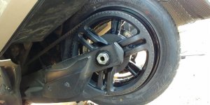

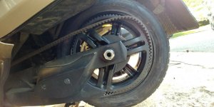

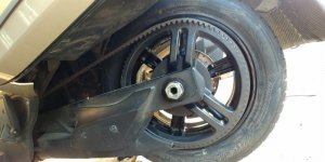

    This next bit no-one seems to believe because it's just too easy; to remove the belt you don't need any tools, yes, really! Chock the front wheels to prevent your Spyder moving, release the hand brake and jack up the rear. I use the shock mount because it's easy. Lie down alongside the belt side of your Spyder in a position so you can rotate the rear wheel downwards. Pull outwards on the top section of drive belt with your left hand and pull down on the tyre to rotate the wheel, the belt will walk a little sideways, continue to pull outwards and rotate the wheel and the belt will eventually walk off the pulley - it takes about three turns of the wheel.
    I have no pictures of it because it didn't occur to me to post the info before removing a belt but it did when I was putting the belt back on so below is the picture sequence for replacing the belt. The advantages are; it's very easy, no removal of parts and no belt adjustment issues.

    Here are the pics of refitting the belt, start by fitting it as far as you can from the bottom then push the wheel upwards - easy peasey...

    Are you saying you were able to remove the tire without removing the shock bolt by rolling your belt off? "your grease seals will be wiped out" are you talking about the seal and o ring?
    Yes.
