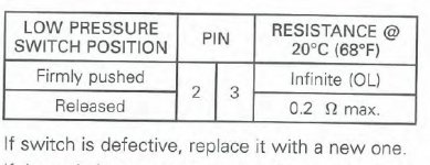

    Hello I am also trying to fix my 2011 RT with the Codes C006c an C0044. What is the test for the brake switches . I only hear one click when I push the brake on. My brake lights go on and off as they should. I checked continuity on the 2 wire switch and it opens and closes as it should . Not sure how the 3 wire switch should ohm out ? Any information on testing that switch would help. Marty

    Hello Billy, what is the test for that low pressure switch ?? I have 10.3 volts to it. When I ohm out the switch it shows closed with the brake pedal up and with it down ??? Could this be my problem? BTW. I pushed the pedal down hard with my foot .

    Fault code C0044 has nothing to do with the low pressure switch. So there are no faults indicating there is a problem with the low pressure switch. So I would assume it is fine.
    But since you asked. See attached screen grabs from the service manual.

    Thank you Billy. My LPS tests out ok . It appears that my VCM is the problem and will cost me a ton of money to replace!
