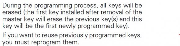

You and your dealer don't seem to understand. The manual is not wrong in this regard. There is a maximum of 4 keys can be programed at any one time. But every time you go through the programming steps and the first new key is programmed successfully. All former keys are deleted. Then any old keys that you wish to keep working have to be programmed again. Tell your dealer to run the steps again and put in all keys that you want to work.
The picture is copied right out of the service manual.
