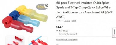

    for not cutting wires, I came across these last year. a "T" splice, that takes a blade to run new wire

    yup these are quite handy when adding items when there is limited slack in wire to work with for a additional splice & even easier if the addition needs temporary removal (adjustments). No wire nuts, solder, or tape just google : spade T splice & can find what assorted value pack will do you best.

    How the heck is that going to work? Don't see how you can add a brake light flasher by just tapping into the brake light wire.
