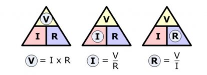

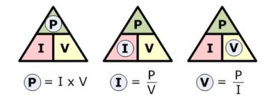

    For all of those who are actually open-minded, can admit they are wrong, and do not pretend to know everything, I humbly offer these learning aides:
    ^^^ Those are likely Not to be found in the cubicles of any Millennial sales / CS weenies, lol. Which may explain the bogus responses.
