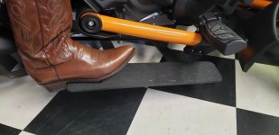

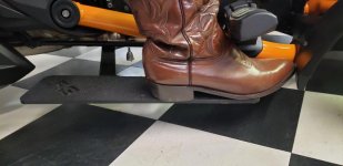

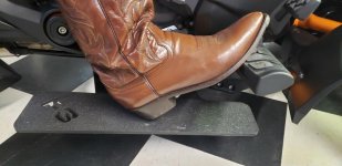

    Anybody got an pictures showing a rider using floorboards? Curious as to how the leg position looks

    here u go;
    locked heel at back end: 20200305_103444.jpg
    mid-way w/toe on peg: 20200305_103524.jpg
