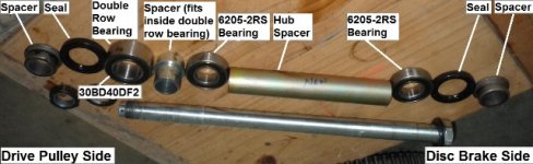

    Here it is, it’s worth what you pay for it. The seemingly never ending saga of rear wheel bearing replacement. Here’s what I found out on my quest. I really appreciate the folks that took time to guide me to the correct answers.
    There are 3 bearings on the rear. 2 single roller bearings and 1 double roller bearing. Interchange Part Numbers are (Not the BRP #.):
    30BD40DF2 (NSK) for the double roller. It is a common A/C clutch bearing for Fords and the like. Measures 30 I.D x 55 O.D. x 23W mm
    6205-2RS, 6205-2RSH, or 6205-2RS1 (SKF Explorer). Measures 25 I.D. x 52 O.D. x 15W mm It is a fairly common bearing, and is the C0, Cn, or Normal clearance. As long as it doesn’t have any letters or numbers after the -2RS, 2RSH, or 2RS1 it is a normal clearance. Suffixes like /JEM or /C3 mean it is a one step looser bearing for running in higher temperature applications.
    You can still source these bearings from the U.S.A. The SKF Explorer 6205 series is now being made in France and Italy, but there are still some American ones out there. You can buy them off of eBay for about $9-$12 each. SKF marks their boxes and bearing races as to country of manufacture.
    NSK bearings are only marked on the seals, I didn't get a box with the one I bought. I was talking to NSK engineering, and they told me that if the seal didn’t have country of origin, it was made in the USA. The NSK 6205DUL1 bearings I removed were clearly marked China. The double roller bearing in my drive pulley hub was unmarked as to country of origin, so it was U.S.A. already. These cost a little more, $25-$28 each.
    If you notice the bearings have different bore sizes. I inquired about this, and was told once I get in there I’d understand. So the double roller bearing has a 3mm larger bore. See the attached pictures, the spacer that fits inside the double roller bearing fills the 3mm space to the axle shaft. I apologize for the weird pic, I had it backwards from the other one so I had to flip it to make it match.
