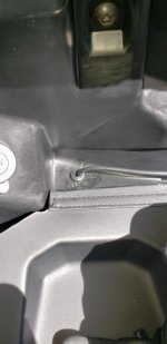

    Finally got around to running an 3.5mm cord from the trunk to the handlebars, so no more blue tooth for music or waze needed. I simply drilled a hole in the frunk on the left hand side, put a grommet in the hole and ran the cord under the seat, to a hole under the seat along the main bar above the gas tank up through to come out where the handlebars are. Here is a pic the wire going through the grommet in the trunk:

    So does this mean youre using ear buds plugged into that cable or are you plugging it into a phone?

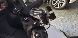

    Nope, I ran a 10' 3.5mm cord all the way to the front, and tied it into my Lamonster Power Plate cord on the Spyder Cuff. Now i just plug that line into the headphone jack on the phone, and music comes through the stereo on the bike. Works great. No more bluetooth, no more phone in the trunk. Power straight to the phone, and the power plate allows you to plug the battery tender directly into it. win, win, win! Here is a pic of the setup on the handlebar:
