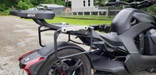

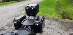

    Ryker 4.jpg OK if I miss anything I am sorry. The plate you see you will have to get fabricated to what style bags you want. Ryker 3.jpg These bag and rear top case mounts are GIVI for a 2013 NC700X Honda. The passenger spot plate will be made to fit the angle of the bag you want. The plate is set on and bolted to the Max mount. I also purchased the passenger seat to get the (P4 cross member) and the (P2 & P3 passenger foot rest) P4 for more strength on the max mount. I will use the passenger foot rest in the down position when the bags are on and loaded. For the VSS calibration. Any bag can be used to your liking. Left bag must be set up or out to clear the drive shaft housing. I went more up then out.Ryker 6.jpg These mount fit the Givi Trekker Outback. 37L side 42L top case. If I missed any thing you can PM me. Glad to help. Going to Rolla Missouri Sunday to visit M2 Shocks now I have my stock shock on 5. He will be building Shocks for the 900ace. I have enough room on my Ryker for a week trip. Clothes, Cold weather, Wet weather, Some tools, a small ice chest and a small fan strapped on passenger spot for motel noise.

    Quote Originally Posted by KID Ryker View Post
    Is that because you already had them or you determined they were the easiest to adapt to the Ryker?
    Already had the mounts, very easy to adapt to the ryker max mount. But most of all I like these bag and they don't stick way out have a lot of room (had to buy). The mounts for the NC700X are very easy to work with.

    I would be a bit concerned with having the weight so high and far to the rear. If you carry a passenger it changes the calibration of the VSS, have you engaged that switch?
    YES. I like it better with out the foot rest down.

    With this design can you just use the top case with passenger seat?

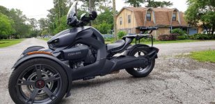

    I also mounted saddle bags on both sides and a trunk behind the passenger seat. Also, I added two speakers on the rear. Consider it a mini spyder LOL
  21. #46

    Quote Originally Posted by TNRyker View Post
    What a good job. Like to see a closeup of the mounts.
    No I can not use the passenger seat with the why I mount my bags. But the new driver back rest I will be able to use it.

    This set up does nothing to make the bike handle bad, if anything I think it handles better. I ride with no passenger so I can carry plenty of gear. Loaded I would still carry a passenger if needed. I have changed the shocks with M2 which have helped a lot.
    Nice job, would love to see the mounting brackets
